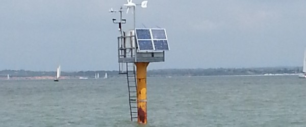

Passing around high water today it didn't look all that much higher than deck height!
It's not on a buoy but a bloody great red post stuck in the sea bed! Granted it's not 10m high though.
About 20’ ish above the high water mark, IIRC?
[Pedant hat]And yellow, not red. [/Ph]

Maybe it's a perspective thing but it looks like the wind generator head is at the same height as the anemometer. If that is the case then in certain wind directions it may well affect the readings. I can't believe they would make a mistake like that though.
