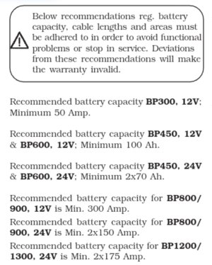

Just noticed something. The OP says ‘50A’ the spec sheet says ‘300 Ah’. Not the same. Which is it?
I think it's an error, probably Chinglish translation since the first two start off referring to AHr and to add to this, you don't get double the current by putting the batteries in series for the 24v versions they also refer to in that sheet, so I'm certain it's referring to AHr.

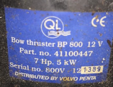

The motor current drain is not mentioned in the manual but Google/AI suggests it's a 5kw motor which means a current drain of 500 amps at start up. Assuming safe discharge of a lead acid battery to 50% capacity, the OPs 50AHr will give 3 minutes of useful life before crapping out (as it seems to be given his voltage readings).
Edited to say, yes it is a 5Kw (7HP) motor as mentioned in this thread:

Re battery capacity, your manual says :
Use an appropriate dimensioned battery with Cold Cranking Amps (CCA) according to recommendations given in the Electrical Reference Guide chapter. Battery voltage must be compliant with the voltage rating of the thruster motor and control circuitry.
The capacity and rated discharge current of the battery should be according to the rated nominal current drawn and the typical duty cycle for thruster operation. The nominal current drawn is listed in the Electrical Reference Guide chapter.
The actual voltage at the motor while running the thruster determines the motor RPM and thrust. Using a smaller cross-section than recommended or a low-capacity battery could reduce performance.
Installing a battery close to the thruster reduces the length of the power cables and potentially increases the performance, due to lower voltage drop in the power cables. For installations on large vessels with bow and stern thrusters or catamarans a dedicated battery for each thruster should be considered.
An installer could work out a reasonable battery to use ie current drain of 740A (12v) 340A (24v) and a duty cycle of 3 mins means a min battery capacity of 80AHr to use 50% capacity in 3 mins. (Actual figures are 37AHr drain in 3 mins). It would be reasonable to double that to avoid caning the batteries on a windy docking day, so 160AHr would be reasonable in my view.
