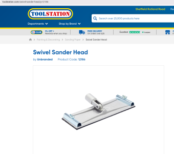

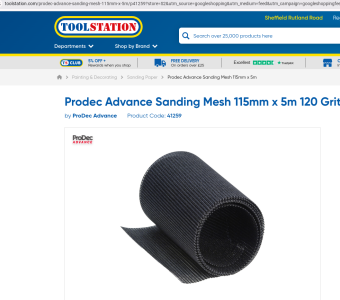

Last time I used wet sanding using sanding mesh and a sanding plate on pole . Very effective .
Fiddly bits were by hand but overall the mess on me was manageable with gloves , safety eye wear and an old high vis coat which I keep for the job.
That's precisely what I use every year on my boat's bottom. Very easy, and stops any build up of antifouling.
