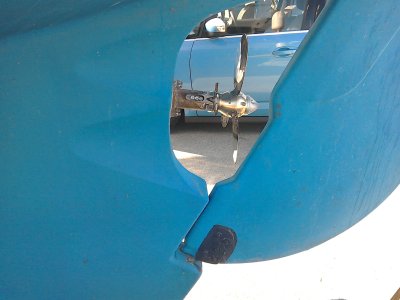

Yes. Props are often supplied pilot bored and bored to size so a prop specialist like Castle Marine would be able to do it. Just make sure you measure the taper and keyway accurately or take the shaft to the machinist. Metric shafts are usually 10:1 but not always. For example Volvo supplied Westerly with metric shafts but imperial taper (12:1). Slight aside, I have a 30mm shaft but a 25mm prop because the Featherstream hub that we wanted to use (to get the largest blade area) will only take up to 25mm. However it is a one way street and doubt you could sleeve a 30mm down to 25mm.
Personally I would not waste money on a prop of that type. I think you will be disappointed. I am assuming it is for your HR. It is not the best folder for performance and worse in reverse. You say the size and rotation is right - have you done the sums? as a 2 blade folder will be a very different size from a 3 blade fixed. The only way you can improve performance in reverse just through changing props is to bite the bullet and fit a feathering 3 blade like the Featherstream or a Maxprop where you can set the reverse pitch different from forwards. For example mine has 10" pitch in forward and 8" in reverse. This makes reverse more progressive and reduces prop walk on a heavy long keel boat. you have to be careful choosing the pitch because it depends on the reverse ratio in the box - mine is 2.5:1 both ways but some boxes have different forward and reverse ratios.
