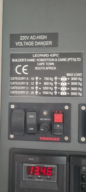

My boat has a C€ certificate with a max capacity of 20 persons Category D. My boat is UK part 1 registered. I'm in Türkiye on a Transit log and I can only carry crew/pax who are listed on the TL. As you can imagine I have lots of guests during the year and I try to get the max number on the TL at the start to save having to do crew changes. The harbour master used to accept a photo of the on-board plaque with the max capacities listed but is now asking for something from the UKSR showing the max capacity. Is it possible to get such a document?

Replies so far bear out what I thought myself. Part of my problem is that the HM will not deal direct. Everything has to be done through an agent. I gave them the Builder's Certificate (doesn't mention carrying capacity) and the original EU Declaration of Confirmity which specifies the carrying capacity as per the Builder's Plate on board which I photographed (below) and gave to them. Not good enough. They came back with some bullcrap about the definition of a passenger ship under SOLAS and said the max allowed is 12. They will only accept something different if it's certified by the British licensing authority - I think they know this is impossible to get so it's a convenient way of saying f off and stop annoying is.
TBH they have a point. Cat D is inland flat waters only - rowing boat stuff. Cat B is offshore. 12 people is the maximum you would get if you used that boat commercially in the UK (assuming it met the rest of the code). The RCD calculations are just mechanistic. 3000kgs is the maximum load, people are assumed to average 75kgs (I wish!) and baggage allowance per person reduces as numbers increase on the basis that crew going ocean or offshore need more including food, water etc than those just sitting on board on a lake drinking Pimms
