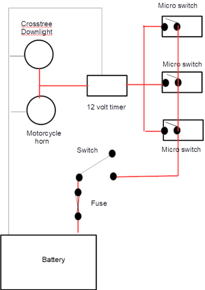

Many years ago my boat was broken into in Singapore.
So I made up a simple alarm system.
The microswitches were fastened with velcro.
Three micro switches for the cockpit locker, companionway hatch and forward hatch.
A hidden isolating switch ( now I would use a relay and fob switch.)
All of the micro switches activated the crosstree down light and a motor cycle horn that was mounted near the companionway through a timer.
This system works as a deterrent.
Actuall,y it was so popular that I made half a dozen up and sold them around the marina. (Ong's)
There was no break in on any boat after that.
Gary
My boat's small enough that with a decent 100db horn they'd disappear over the stern from the fright - I'm liking it, except I'd probably forget to disarm it one day...

Bolt cutters, crowbars and battery disc grinders will get the hatch open
, but if a horn and light goes off, those little sh#ts will hoof it quick smart.
I call that damage reduction.

probably - but if it goes off as a false alarm (especially more than once) the people what might be most likely to spot something suspicious (ie. the land neighbours) will perhaps not be so helpful!
A PIR activated light probably makes sense. An alarm that I might forget to disable before I trigger it, less so.
