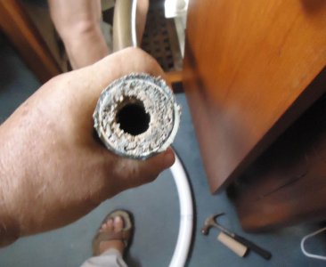

So we had the dreaded blockage on our Jabsco yesterday, we removed the pipe from WC to anti syphon and thrashed several kg of scale off the sides, my question is, How does the other pipe that goes down from there to seacock get affected by the scale build up? We are reluctant to remove it because the sea cock is stuck open!, allthough I, as a plumber am not scared of the pathetic 0.01bar pressure you get from 10cm under water!
I figure that unlike the dirty 'up' pipe, the water falls down to sea level in the 'down' section and as our seacock is open that would mean fresh water bobbing up and down and hopefully cleaning it?
Wondered if anyone has noticed severe build up before anti syphon but not after? hoping I guess, because we have a few sails left until the boat can be taken out of the water.

Both sides can and often are affected by build-up. If one side was badly clogged, the other side won't be much better. While you are at it, clean the anti-syphon as the valve often gets clogged as well.
If the pipes are old, better to replace them than bang them clean. New pipes are softer and easier to re-fit.
You should be concerned about your stuck open sea-cock: it needs to be changed. Loo outlet seacocks are particularly prone to this. Do not think for one moment of doing away with it! If you are a plumber and not worried about a bit of water, it can probably be changed afloat. First check if the sea-cock can be turned very slightly without disturbing the skin fitting. If so you are in business. Swim down and knock a bung into the outlet to stop the worst of the flow. Then cut off the pipe (easier than trying to pull off), unscrew the old sea-cock from the skin fitting, and fit a replacement using PTFE tape. Do this quick and you won't have more than a cup or two of water come in. Open the new cock, poke out the bung, slam it shut and refit the pipe. Best is two hose (jubilee) clips on underwater fittings.
Old toilet pipe, cut off at the seacock. Note the bung and hammer.

thanks for the tip about flexibility of new pipes, I wonder if they are less prone to build up also? thats exactly what we found that! I'm just convinced that due to the self draining of the down section plus the permanently open seacock meaning it gets swished with fresh seawater will mean that it won't be as bad as this- what we found in down section. will find out in the spring and add to this thread if I remember! i'm thinking of manufacturing a solid pipe up from skin fitting to above sea level and relocating the seacock there so that it can be A left open without worry (on flat moorings!) and B be changed / inspected whilst afloat easily, obviously that solid section needs to be bullet proof . surely someone has done that? as i said, the drains from the cockpit are exactly that, nobody worries about them leaking because they are solid and integrated to the hull.. I do check they look fine whenever i'm down there though!!!
I don't know what the answer for a hard to access seacock that is too stiff to close is? longer handle would be good i guess, but not sure there is room, its out of sight under cylinder, accessible with left hand only, not ideal. any recommendations welcome

It is the combination of urine and seawater that causes the build-up of scale. The usual solution is to ensure that the system is well pumped-through after use. I don’t usually rely on guests to do this and give it around twenty pumps, especially before leaving the boat for a while.

The scale is formed as a result of bacterial action on nitrogen compounds in the urine producing ammonia. The ammonia raises the pH which leads to bicarbonate ions in the water being converted to carbonate ions. This results in the deposition of insoluble calcium carbonate.
Fresh water contains a much lower concentrations of both bicarbonate ions and calcium ions therefore, although the same reactions do occur, the scale deposition is much less.

Update. It happened again ! The one small bit we didn’t attend to - in the bend. ! You can see here that the down section was fine as I’d predicted as it’s always empty due to anti syphon
