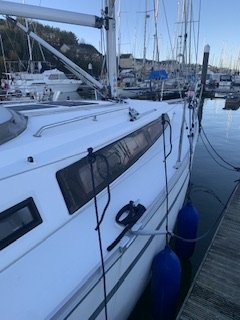

Here are the windows on my Bavaria 33 Cruiser (2013) that are leaking:

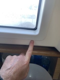

The water is appearing, both sides, at the very aft of the window (lowest point, I think):

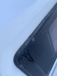

The external seal on the window looks original and very tired.
My question is this. Do you think I can cure the leak by simply replacing the external seal around the edge of the window. I expect it will be a messy and laborious job but basically doable. However if it is unlikely to work I probably won’t bother. The leaks are a nuisance but I could live with them. Many thanks in advance.

Im not sure that seal around the outside should be there in the first place, but added to try and stop leaks.
Resealing around the outside will temporarily work, maybe for quite a while, maybe not.
The hard part is finding a product that really will bond to acrylic/polycarbonate and grp/gelcoat.
Usually whatever you try will end up leaking again leaving a removal and reseal of the window the only way of fixing it.

it could be the window has been fixed in place with an adhesive system. Then a rubber strip could be over the top is to a) act as a spacer to ensure the adhesive is not squashed to less than it’s designed thickness and to protect the adhesive from UV. Usually the a Matt black paint (primer) is applied around the edge of the Perspex to again protect the adhesive from UV. Though I could be wrong and maybe the rubber gasket thing is the seal and fixing. Try Bav owners web site.
By the way, that looks to be quite a long length of window. In the hot sun the expansion of the Perspex could be more than expansion of the GRP underneath, resulting in stress on the method of sealing. Also the boat might be very twisting very very slightly across that area which again stress the method of sealing. Over many years it could maybe cause the seal/glue to fail.
Sika make/made a marine product set suitable for adhering perspex(?) to grp/gelcoat.Two different primers and the adhesive. It is very good.

As per Channel Dailor’s post.
Previous threads on similar windows and boats, suggest the sealant is breaking down. The black shading on the plastic window edge is to shield the glue from UV degradation. However, the sealant still degrades.
According to these posts, the window has to be removed and re sealed. The significant issue is that removing the window is difficult and they crack or split. Windows that have been moulded in a curve usually can’t be bought as models changed and stocks of replacement windows are low to non existent. Making a new replacement window now falls into the one off, custom space, and are very expensive.
At least with a flat window, there is a better chance to replace.

I too think it's likely that the adhesive/sealant is breaking down. We have had the same with windows fastened by adhesive (not Bavaria). We bit the bullet and replaced three - indeed paid someone to do it. It looked difficult getting them out undamaged and very patient work re-seating them. In a couple of places on ours the sealant was too thin. My understanding is that, as channel Sailor says - the sealant needs to be both flexible, and thick enough to deform and accommodate the stress of differential thermal expansions of the window material and hull.
In case it helps with the final leak on ours, we have simply taped polytunnel polythene over the whole thing with waterproof tape, replacing each year, 7 years and counting. Completely dry, it's a window where the view doesn't matter, but it looks awful from outside!
