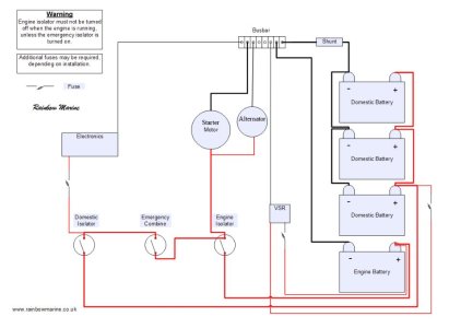

may be both switches have to be on, either way i'd not be happy with that set up
from paul rainbow on this forum and what i changed my set up to :
