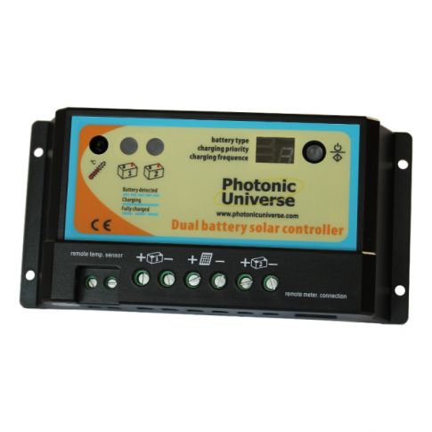

Buy a dual battery charger. I'm just about to fit one of these
which is about £35. For another £35 I have added one of these
which lets me monitor and control everything remotely. You can tell the controller what type of batteries you have, which one you want charged first and it does the rest. I haven't tried it yet, as connection day is next week sometime, but the reviews seem OK. Photonic Universe seem to be the main importers, but they are available unbranded from other companies. Worth checking prices direct, though ebay and through amazon as well as directly. The remote meters seem to be in rather short supply at the moment.
