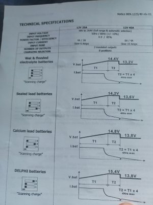

I have a 2007 Beneteau with a Dolphin 12v 40A charger (REYA code 299740).
I have:
2 Lead acid Starter batteries that I can check and top up if necessary. They are each connected separately to the charger. Batteries are 5 years old.
2 Sealed lead acid Domestic batteries. They are connected in Paralell to the charger. Batteries are 2 months old.
The dip switches are set for 'wet and flooded' batteries.
The problem is that the charger seems to stay in equalisation mode for a very long time instead of switching to float. Today they have been in equalisation for more than 24 hours.
