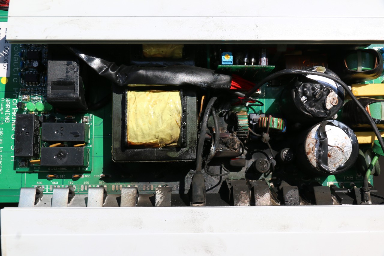

My battery charger on the SC35 has gone bang.
A small amount of smoke, breaker tripped, etc.
It was a "Promariner ProNautic 1240 c3".

Due to the expense of a new one why do you not have your's repaired?

Strangely, although I have disconnected the 240v input and all the 12v positive connections at the battery ends, the little fan inside the dead charger is still unhappily whirring away.

What are you going to do with the old one?
If you don't want to repair it, I would be interested in having a poke around in it before it goes in the bin ...

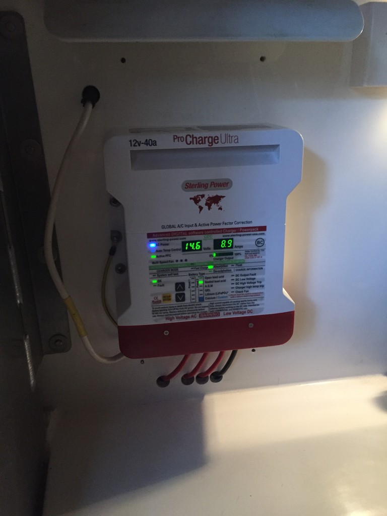

Happy Days :)
Still need to tidy up a bit, fill in screw holes from old charger, but that can wait until next weekend.
Thanks to all for the advice, but I went for the Sterling in the end because it seemed a bit more "digital", cheaper, modern, supports more types of batteries out of the box, and claims to have a more sophisticated charging profile.
The Victron I'm sure has great quality components, but felt like a more dated industrial-grade product with a simple timer between modes, and being heavier, would have been more difficult to install in the confined space.
