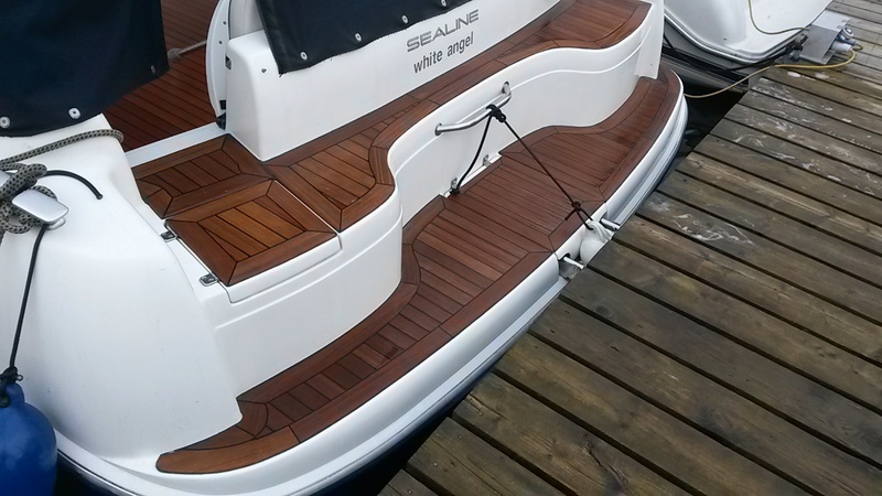

By coincidence I used the Wessex cleaner today. The teak is still wet in the photo. Despite the wind this afternoon it was reluctant to dry off.
