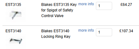

My dream is to be in an industry where I can command margins like this: Spigot Key Safety Control Valve
A defence contractor would be jealous!
Yep, they’re the undisputed masters of Marine Pricing Startegy. When I had a Taylor’s stove one of my favourite entertainments was to browse through their website in sheer wonderment at the spare parts prices. If you were to buy every part to construct a drip feed heater you would need to remortgage your house. Genius’s.
