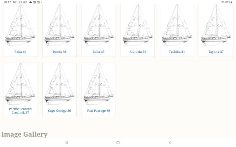

I found this many years ago but don't know from where . It suggests any one of these 9 boats are the same so may help with your research ?
Add a hans christian to the list..

Seems that hypothesis can be discarded: neither of the two below had a bowsprit, nor even long keels:
PS 37
FP 39

Actually, those on the list are completely different designs, they just used the same stock drawing (of a Tashiba 36) as an illustration, regardless of the actual boat. Most of them have canoe sterns, but the Cape George 36 has a transom stern, while the Panda 38 has a counter stern; the Cape George and the Tayana both have a full keel with no cutaway forward, while the Crealock 37 and the Alajuela both have a fin and skeg profile. That said, the Baba 40, Tashiba 40 and Panda 40 do indeed share the same hull.
The Baba 40/Tashiba 40/Panda 40 all have a J measurement (mast step to jib stay chainplate) of 21ft, so that would indicate about a 5ft bowsprit: all drawings show a plank-type bowsprit with a pulpit rail around it.
