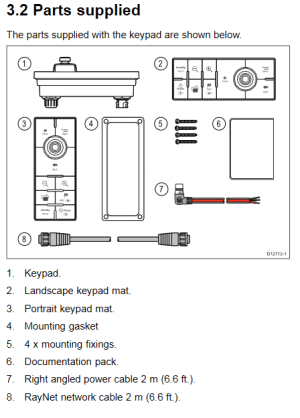

There’s a separate remote available (RMK-10) for the Axiom+ that provides the buttons. It’s not cheap but the price of both together is less than the Pro.

Its worth pointing out that the remote uses a network connection (Raynet, but its just ethernet with a fancy plug), the Axion + only has one such connection, so if you are using it with another one at the chart table (to share the same chart card) or if you have a radar plugged into it as well, then you would need a network switch.
In terms of your question, I would say the physical controls are nice to have, but I've always been able to make the touch screen controls work for me, even in bad weather. The pro does come with two network connections rather than one, if that's a factor for you.

The Remote Keypad needs a RayNet (Ethernet), not a NMEA200 (SeatalkNG) connection to communicate with the plotter. The Axiom+ only has one RayNet connection so if you are already using this connection (e.g. for Radar) then you will need an additional switch which adds to the cost.
The Axiom+ also has it's card reader slot at the rear, so depending if you want access to the card, and how the plotter is installed, you may also need a remote card reader too which is USB and plugs into the rear accessory slot. ....
The Axiom 2 Pro has both buttons and the card reader on the front panel - and 2 network connections. So depending on your needs, the worst case scenario for an Axiom+ may mean you need a RayNet switch, an extra RayNet cable, a remote keypad, and a remote card reader .... which makes the price difference not so great.
PS: Beaten to it by @Ceirwan ... definitely look at the complete picture dependent on your needs, Axiom+ may end up being a false economy. Haven't used mine on the boat yet - install is in a few weeks - so can't comment on the usability of the touch screen, but the combination of hard-wired Radar, the number of RayNet devices I have, and concerns about a touch screen in the cockpit caused me to go down the Axiom 2 Pro route for the helm station.
