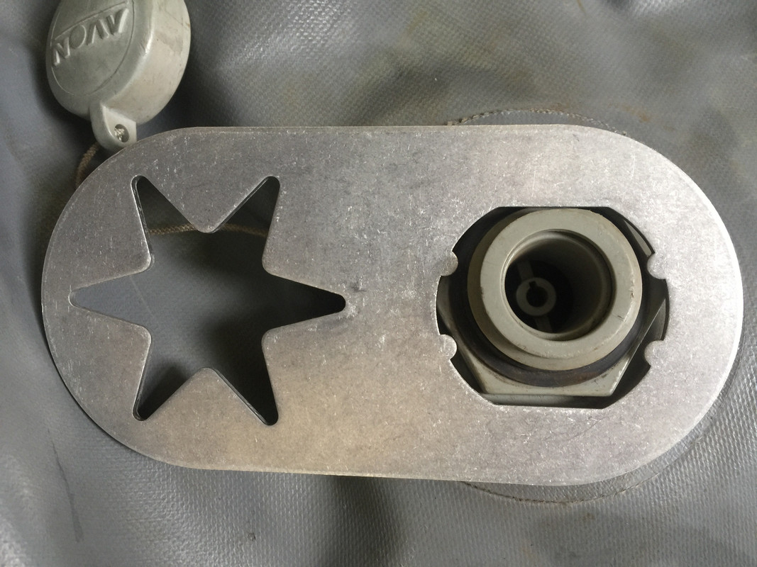

I have been trying to shift the big grey plastic nut in order to replace the innards.
Has anyone ever managed to do this, and do I need to spend £120 on the wrench in order to replace the £5.90 valve stem and diaphragm?

No You should be able to find them at least £100 cheaper, but you could make one from ply.
BTW this looks like a decent video showing how to replace the guts of the valve
https://www.youtube.com/watch?v=D_ZIt4VvWYs

I've watched that video a few times. He's somehow using an A6 /B7 spanner (seen clearly at 2.31 on the video) on a purported A7 valve. I have one, and mine most certainly doesnt fit an A7 valve! :) Hence my mystification

Just use the right wrench for your valves, make one or do as Ribstore suggest; "For A7 - use a socket/spanner or a large pair of grips (use a cloth to cover the jaws of the grips to prevent damage to the plastic valve)" They dont seem to offer a wrench for A7 valvea but this one apparently fits A7, A6, and B7 valves
I had this problem...I clamped the fabric in a vice as close to the valve as possible, and used a Stilson wrench with a extension bar. The material is much stronger than one would think. No damage done.

Once you get that nut off, I would interested in how you then proceed because I couldn't get the body of the valve out of the hole for love nor money. I found some amber flat ring stuff broken up inside the seat which may or may not be part of the valve floating around in the seat. I have emptied this out but a slow leak over an hour remains.
The plan was the replace the whole valve but may have to end up taking it apart inside to replace the bits.

I had planned to change my valves but found the same problem. I have since rebuilt the faulty ones with the, very cheap, parts. I remember thinking it would good practice for a gynecologist!
I saw a video on youtube about changing the valves and you have to replace the circular patch with the valve. Far more trouble than changing a few bits.

The video link in #2 shows you how to replace the valve internals .
To get the valve out in order to replace the whole thing you have to make two small cuts in the fabric and fit a patch as part of the repair as you say
This video shows the procedure
https://www.youtube.com/watch?v=AkshJaBhNR4
I just changed the mushroom valve and spring part, with (i think) OEM parts, several years ago, fine since. Was not happy about cutting/patching
I have a similar problem. The large gray nut comes off easily but the valve itself will not separate from its housing so I cannot turn it around to replace the missing diaphragm. I suppose the valve was glued to the housing. But now reading this thread I am not sure if I have to cut the fabric in order to remove the valve from the housing. According to leafield images, the A7 housing should be separate from the valve. the gray-white disk in this image is the part I cannot separate. Any ideas? Thanks

As you can see from post 13, I did mine a few years ago. They are still fine after a great deal of use. I would try, carefully, going in-between the docs and the material with a thin blade, then try twisting the disc. From memory, there may be a white sealing washer somewhere, possiblity under the disc. There shouldn't be any glue or sealer on any part of the valve but it depends on what has happened in the past. The material is really robust.
