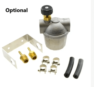

ok, thank you Owen. Ill remove it next weekend. I do also run this fuel filter, i also use the separate fuel tank it came with. I topped up with new fuel onto existing around 2 months ago.
