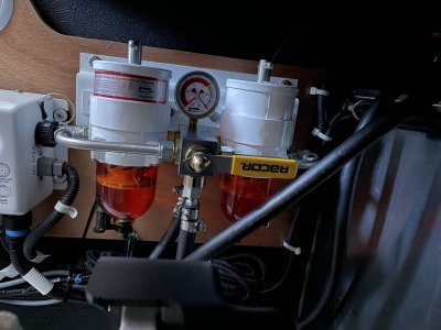

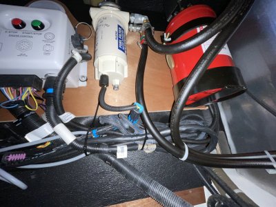

I'd be interested to hear about your filter changes.
Before and after of the filter changes…
after:
Did you determine the source?
We suspect someone in its past ownership thought they were filling the water tank.. the filler for that is right at the back, whereas the fuel filler is near the waste pump out… 20 litres is about 2 large buckets.. Part of investigations for other likely sources meant getting hold of some detailed schematics of tank, filler system and vent from Beneteau which are useful to have… that’s probably worthy of a thread of its own..
