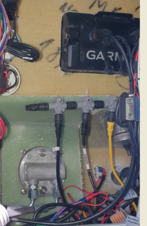

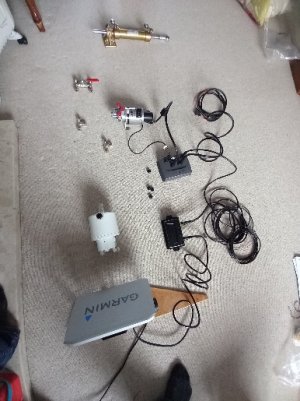

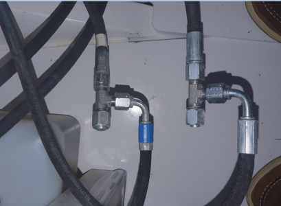

the T connectors are already present, no return line yet (yes the 2.0L pump will fit through the apperature, rubber feet, Dimensions (L × W × H) 31.75 × 11.43 × 10.16 cm)
