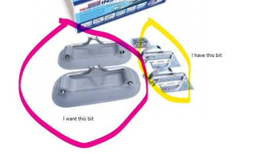

Anyone know where to buy the little pads for a dinghy to fit snap davits?
ontheplane
20 Mar 2004
2,072
Bristol UK
Hiya,
Have had an offer on a boat accepted - photos and so on to follow shortly.....
The boat has snap davits fitted but no tender - so I need to get a mini rib or similar....
However everywhere I look - to buy the pad I need to also buy the snap part that is on the boat - and I have that bit already!
Does anyone know anywhere that just sells the pad and metal u shape bit that goes with it to fix the dinghy onto the boat?

I bought replacement pads from polymarine, you have a choice to buy the originals (Weaver) or their own brand (instalock). I bought polymarine instalock which are just as good and no issues since fitted about 3 years ago.
Snap Davits
I also recommend buying their strong cleaner and glue, although pricey worth it if you don't want to do it again in a few years.
Edit: the rubber pad and metal arm are two separate parts.
Single Insta-Lock Rubber Pad
Single Insta-Lock Bar
Thank you and that's exactly what I want - but what a price!! ?
That comes to £191!!
I was looking at these - not sure if it's a pair or just for 1 304 stainless steel quick release snap davits set instant - Temu United Kingdom
Includes the "Snap" part as well....
Yes I was shocked at the price too, but still cheaper than the original weaver price.
I did look at the rubber pads in your link when I was replacing mine, I liked the idea of the handle integration, but some of the reviews weren't good, I think from memory the key issue was the reduced rubber pad area that is glued to the dinghy, it doesn't support the weight and comes apart overtime, so I decided to go with Insta-lock and to be honest no regrets.
Go for whatever "pads" have the largest surface glue area.
The most likely future failure will be the pad/glue/ dinghy tube interface.
