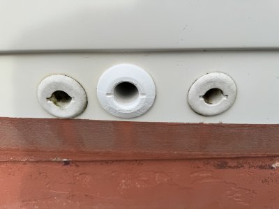

Any idea where I can buy these?
Glasto1
21 Oct 2023
18
Hi, I am guessing these are drains on the side of my boat. They are not in good condition, where can I get replacements?
Bandit
30 Jun 2004
3,542
Guernsey
Normally going back a few years the above waterline skin fittings for sink, shower or deck drains were plastic rather than composite. Sometimes they snap off on hose tails as they become brittle. Most hood chandleries stock them, inspect or replace the hose to it and check all jubilee clips.
