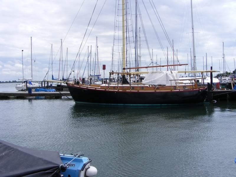

This one was built from scratch and launched at Prinsted, Chichester 3 years ago. It's still there and still not quite finished. Its been about 20 years since it was started!
