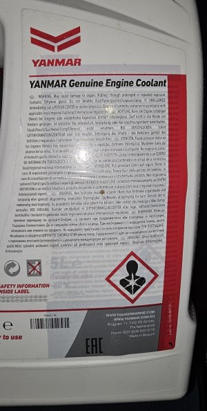

Having successfully manage buy a suitable oil for the Yamnar 4JH4E, I now need 10L of antifreeze.
The lower hose on the fresh water cooling system is leaking. I have a new hose and hose clamps, but when I take the hose off, all the coolant will drain out.
I'm fairly sure I should be able to buy an equivalent from the local garage, but what to ask for, besides it being orange?
Are there different types of orange antifreeze and if there, are can you mix them?
