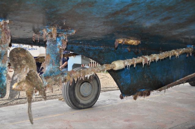

I've never antifouled propshafts but I must confess to wondering whether to do something this year after seeing the state of Formanda's sterngear on her lift in August. This was after two years in the water:

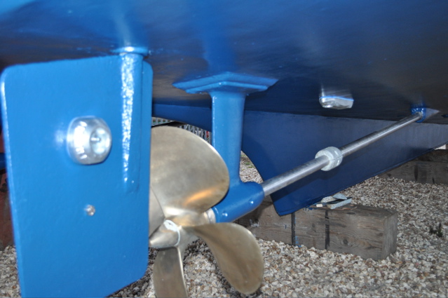

A lot of elbow grease and some concrete cleaner later and we were back to normal:
I was originally planning to try smearing some lanolin on the sterngear prior to launch, as I have heard positive noises about that over the years. But my thought that there was a pot of the stuff buried deep in Formanda's bosun's locker proved false. So we didn't coat the props and shafts with anything, just gave them a good polish. The P-brackets were already antifouled when we got Formanda so we kept up that regime. Hopefully we'll be more active with the boat now which will help keep the sterngear a little less biologically challenged in future. Either that or we certainly plan to make the barnacles somewhat dizzier!
