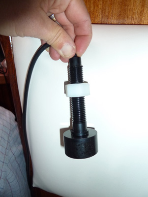

Looks exactly like the transducer I found on mine last year - same coax fitting as well....
Something like this... note, no hole through hull
attachment.php
The transducer should look a bit like this???
Thanks for the replies! I didn't check if the nut on top was actually plastic, I think it was though, which would make sense it being a transducer. (I'll be cursing if I get face full of water! :D )
Unfortunately I don't think my transducer will fit - but the good news is that my transducer does fire through the hull, thanks to Vic for getting me to try. I'll try the fit and see..
