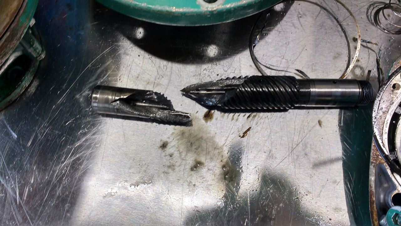

Another MS4B bites the dust.
oldgit
6 Nov 2001
29,339
Medway
Fortunately its a bit that VP still keep on stock.
Unfortunately boat has those deep sea seals fitted which means boat has got to come out of the water.
Third bit not in picture which also sheared , basically the top third of shaft.
Skipper adamant that he did not strike anything prior to failure.
Perfectly OK on journey until coming to a halt and then no drive.
