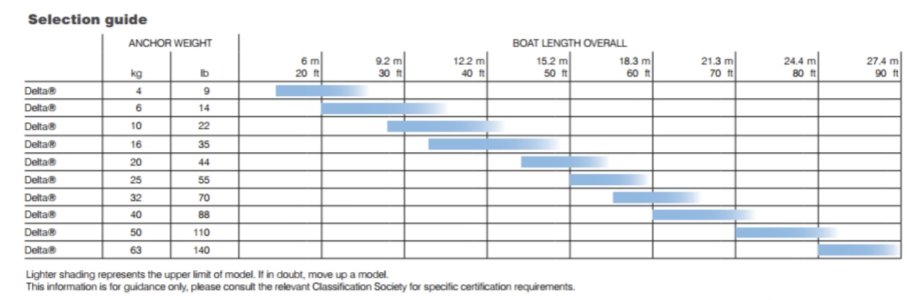

I used your yacht’s listed displacement on salboatdata.com of 14,500 kg (32,000 lbs) for your 44 yacht when determining the recommended anchor size. If 18t displacement is used, it further proves the trend as the recommended sized jumps for the better anchors as you indicate.
Spade to 30kg (although it should be noted this model is suitable for yachts up to 66 feet according to Spade), Rocna 33kg and Ultra 35kg. Delta and CQR anchors stay at 16kg further proving the point.
I am not sure where you determined a recomended Delta size of 25kg for a 44 foot yacht, but even if this is correct it is still one size lighter than the recommendations for the significantly better quality anchors. Showing how anchor sizing tables make little practical sense in the real world.
However, below is the official Lewmar sizing table for the Delta anchor (the CQR table is also very similar). Using this for a 44 foot yacht most people are going to select a smaller Delta than 25Kg ( perhaps a very small 16kg?) if they are trying to follow the manufacturer’s table especially if they believe the (incorrect ) warnings that are frequently voiced on this forum to "never oversize their anchor".
