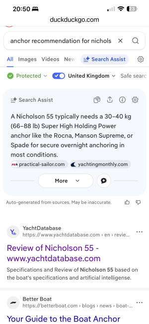

Just for fun I asked AI; this is what came back:
Not that I would pay attention to AI. I think all it is doing is weighing the number of times different anchors get mentioned on the Internet and that’s why Rocna leads the pack. It doesn’t seem to think my 40kg Delta is too big, though. It also wants me to use a 7:1 to 9:1 scope, no doubt on the same basis. It can p*** off.
