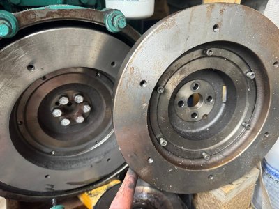

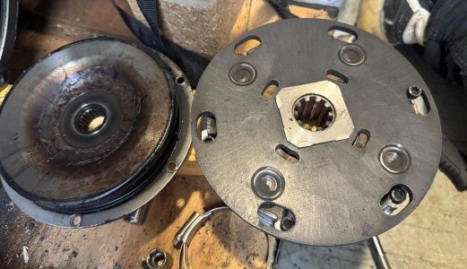

Well I didn't see that coming. The 2020 has a 4 bolt flywheel but the 2030 has a 6 bolt. I'll just be reusing the original 2030 one with the output spline part swapped over. I quick check of the depth should alleviate any concerns. The backing plate where the shaft box bolts onto has the identical part number to that of the saildrive box so I am very confident with the swap.
