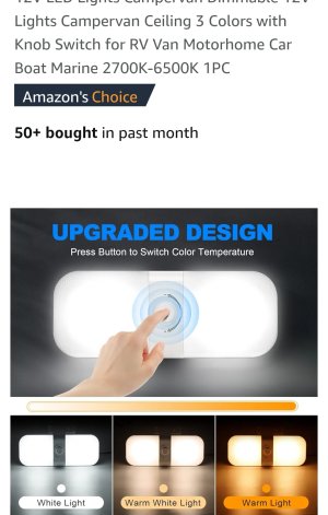

Yes, in series. I have 2 lights with USB like the ones in Stemar's post. 2 spot type where the original bulb has been replaces with leds, one led over the sink, and a new cabin light like this pic below.
Thats that's 6 in total.
