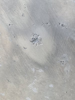

I cleaned it fully back when i got it home and pressure tested it which was all godd.. I found a couple.of areas I am not 100% on. Pitted areas.
I thought on filling the pitted area about which is around 7mm and with either epoxy filler or metal putty. is it that bad to get a new tank made? I could ask at work if they will make me one if need be.
On a vernier it is .24mm deep.

If the tank is 2.5mm thick it's a bad idea if it's 6mm thick then it's going to last a while longer. You get the idea.

You could weld patches over the pitting to reinforce the tank
Well ad a more closer look and there are atleast four more corroded spots.
think it will be a new tank for peace of mind. ill see if work will make me one or look at PCUK`s idea. or get a plastic one, no as dear as SS or ally..
My aluminium fuel tank was seeping from the bottom. Emptied the tank, took it out and found lots of pitting and pin holes of varying sizes in the bottom, probably caused by chemical reaction between the fuel in the bottom and possibly fine sediment with corrosion eating its way out. I had the bottom plate cut out and completely replaced. Cost me £80 at a specialist welding company. Professionally, I have also witnessed this in other vessels where if you patch the holes you just end up chasing leaks around, as one after the other, the pits developed in to holes. This has happened on steam boilers (oxygen corrosion and pitting) and the double bottom fuel tanks on ships where the crud in the fuel settled at the bottom and became infested with bugs that then digested the fuel. Then, over time, the bug by products attacked the steel plates requiring drydocking, replating and thorough decontamination. When the replacement plate was welded in to my aluminium tank I had the bottom of a thicker plate than before and of a more resistant grade of aluminium. I wasn't going to stop the corrosion but I could delay it.
I'm sure you will do a very good job in repairing and restoring the aluminium tank, but you only need to miss one tiny pinhole or not cover a corrosion point, and there will be nasty leaks and a lot of extra repetitive work.

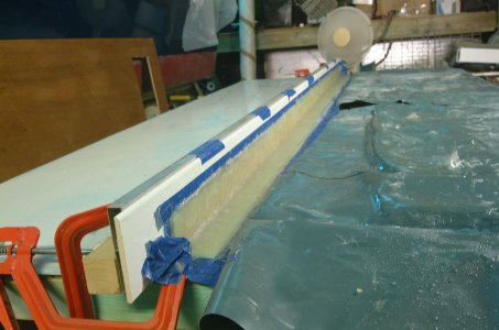

Pic 1. Hull ground back to clean fibreglass and new side stringers glassed in prior to applying three layers of isophthallic resin and mat.1.jpg

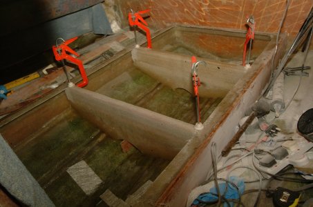

Pic 3. GRP angles ready for bonding in.

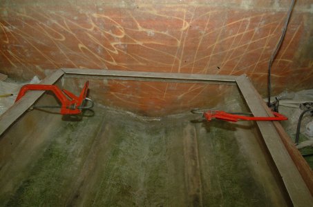

Pic 4. Baffles moulded and ready for bonding in.

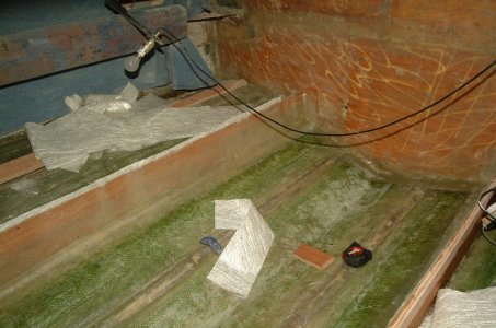

The top was made from 18mm ply sheathed with layers of the same mat and resin on the inside.
A Nitrile gasket that covers the entire tank top inside was sandwiched between the supports and the top as the whole lot was screwed down.

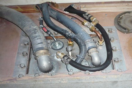

5. I later added a stainless panel carrying the fuel filler, breather, Engine feed and return, Eberspacher feed, fuel gauge sender and Marine 16 Dipper pick-up. You can just see the edges of the Nitrile gasket along the edge of the panel.
