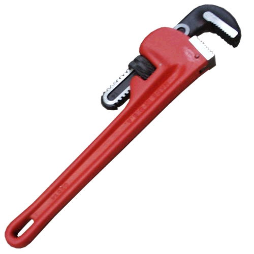

Pipe wrench like this;
The jaws pivot slightly & turning tightens them. But take care, if it doesn't free it, it will destroy it. They are Very powerfull tools. Mole grips is another idea & putting it on in a couple of different directions may flex the cap enought to free it a little. A kettle of hot water will always help first.

Searush thanks for that but unfortunately its a flush cap fitting like this:
