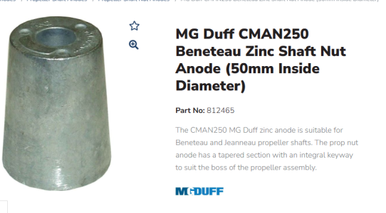

It says zinc.

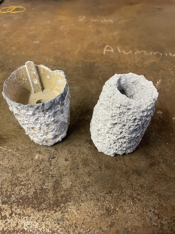

Zincs I can get from my local chandler. They offer to order aluminum for me...but no one has accurate pictures or diagrams as to what the anode will look like....and they all differ in some way
Apologies - missed your requirement for Aluminium
