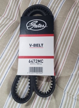

I found the VP belts shed a lot of black dust on our MD2020, probably due to the extra load from a Sterling A2B. Replaced with a Gates Quadpower Belt from Bearing Shop UK (<£15) and no problem after that.
