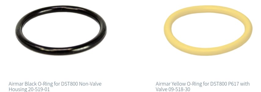

11 Jul 2023 #2 Martin_J Well-known member Joined 19 Apr 2006 Messages 4,405 Location Portsmouth, UK Visit site Not to muddy the water but don't they have a choice of o-ring depending on whether you have a valved or non-valved through hull. I know the transducer has.. Whichever, I have an install kit with both on board and can measure tomorrow.

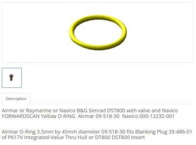

11 Jul 2023 #3 Martin_J Well-known member Joined 19 Apr 2006 Messages 4,405 Location Portsmouth, UK Visit site don't ask me how.. I have no idea, but I was just searching my laptop for my sail dimensions and in that sail folder was a file called 'yellow o-ring detail'..

11 Jul 2023 #4 Martin_J Well-known member Joined 19 Apr 2006 Messages 4,405 Location Portsmouth, UK Visit site Looks like that was on the JGTech website Airmar and Navico FORWARDSCAN O-RING Airmar 09-518-30 Navico 000-12232-001

11 Jul 2023 #5 Martin_J Well-known member Joined 19 Apr 2006 Messages 4,405 Location Portsmouth, UK Visit site What a minefield.. Looks like my replies are for the wider DST800 (not the ST800) series..
