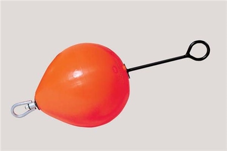

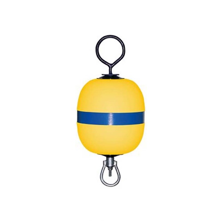

This sort of thing?
Available in several sizes
http://www.gaelforcemarine.co.uk/en/Polyform-Mooring-Buoys-With-Long-Iron/m-2718.aspx
http://www.gaelforcemarine.co.uk/en/Polyform-MR-Foam-Mooring-Buoy/m-2723.aspx
Or
http://www.marinescene.co.uk/view/10884/majoni-rod-buoy-size-1
http://www.marinescene.co.uk/product/10883/majoni-rod-buoy-size-2
Thanks for the suggestions. These look a little short on height and the buoy may be unstable. Also I am thinking of something that has an open arch rather than a closed loop for ease of casting off and picking up.
