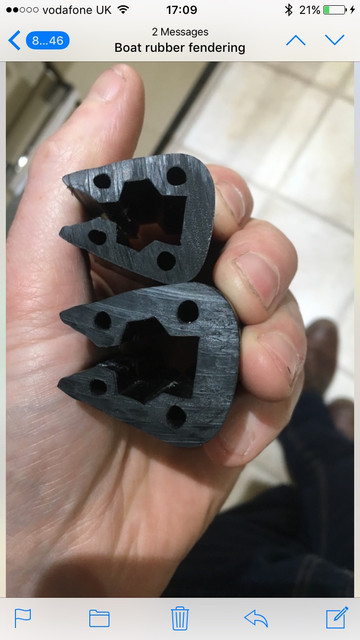

Hi, I have just re-sealed my hull to deck joint in a couple of places and as the original rubber fender strip is old and scratched up I may just buy some new fendering.
It looks like the old fendering was kept on with contact adhesive but someone suggested I could use some CT1 on the inside of the new fendering before it's fitted.
I have a few samples of fendering, some soft enough to use cold and some that need warm water, even if I use the one that needs warming I can blow the water droplets out with compressed air before applying the CT1.
Any advice will be greatly appreciated.
