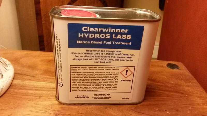

For a change I am trying this .................
.......or will be when I add some fuel.
