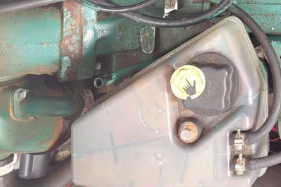

21 Jan 2024 #1 B Banksy New Member Joined 21 Oct 2023 Messages 22 Visit site Hi, can you tell me what this tube is for? I thought it's either a breather or it has a cap missing? to the left of the expansion tank.
21 Jan 2024 #2 M madabouttheboat Well-Known Member Joined 20 Jan 2005 Messages 1,584 Location UK, but for Covid it's England Visit site its an oil extraction pipe.
21 Jan 2024 #3 B Banksy New Member Joined 21 Oct 2023 Messages 22 Visit site for my oil changes? so there's a cap missing?
21 Jan 2024 #4 S Scubadoo Well-Known Member Joined 16 May 2001 Messages 2,025 Location Hampshire / Solent Visit site Glasto1 said: for my oil changes? so there's a cap missing? Click to expand... Oil extraction for oil changes and yes the cap is missing.
24 Jan 2024 #5 O oldgit Well-Known Member Joined 6 Nov 2001 Messages 29,585 Location Medway Visit site Anything that fits will do................... ie Felt tip pen cap etc.
25 Jan 2024 #6 B bowler Well-Known Member Joined 13 Oct 2014 Messages 516 Location Ireland Visit site Buy a 12v pump for your oil changes and the rubber end caps that come on it will fit your tube. They are cheap from ebay and well worth it for smooth oil changes. 12V Electric Car Oil Extractor Diesel Fuel Fluid Transfer Suction Syphon Pump UK | eBay
