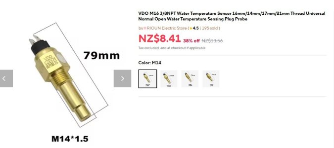

Hi, I ordered a new 14mm thread water temperature sensor for my Bukh. When I screwed it in, it would not tighten. So I had the wrong thread.. looking again I see another sensor 14mm x1.5 - is this the correct thread for the Bukh?
thanks
see screen shot attached....

You've got the engine. Measure the thread and find out.
According to this old thread, it appears to be listed as a standard M14 thread.
Er, refer to Post #3, there's a choice of three standard threads.
M14 can have thread pitches of 1, 1.25 and 1.5 mm. 1.5 mm is the standard ISO pitch but Bukh may have used any of them. Can you not measure the old fitting?
Measuring the thread pitch on an internal thread is non-trivial, or at least I find it so.

Thread gauges are useful things to have, but I can think of three improvised methods for measuring an internal thread. It really isn't difficult.
Do tell.
Or are you "Penberth 3, International Man of The Three Mysterees?"
I tried taking an impression with RTV on a stick, which sort-of worked, just not quite well enough.
In the end buying the bolt selection was cheap, simple and effective.
So, that'd cost me about 20 quid with shipping, take a few weeks to arrive, MIGHT work in my hands (never used one) in the rather awkward rather deeply recessed location, and if it did then I'd STILL have had to find, order, and have delivered an extractor of the (hopefully correctly) measured thread pitch, or buy the (hopefully correctly) measured thread pitch bolts anyway.
As opposed to just buying some bolts
