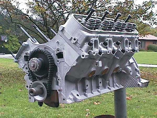

2) Cambelt - cars are easy - if it's getting to 5yrs and 50k I'd be changing a cambelt. Does this engine have a cambelt, and if so, how easy is it to replace? These GM blocks dates back to the late fifties and have a chain driving a centrally placed camshaft - no belts

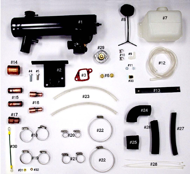

Yes indeed. Come as kits, mentioned in my reply as FWC (Fresh Water Cooling).
"Half" kits cover the engine excl manifolds, "Full" kit covers all.
Does not have to be Volvo. Several alternatives around

Think FWC kit is some £750-1500

Yes - the FWC kit seems about £1500 - where I could get one for £750 I don't know - might (just) be interested at that.

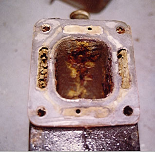

Raw water riser or manifold, where it mixes cooling water to the exhaust

Goes without saying that blocked ports prevents proper cooling (and whatever disasters that may bring in term of blown head gaskets, oil/water mix etc.)

Your FWC risers pic isn't coming up but the water going through the risers will always be raw water regardless of cooling system. The only way to have fresh water going through the risers is to keep the boat on a lake :)
