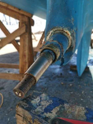

What is the tubular cover over the shaft that extends from inside the boat to three quarters of the shard length. It was loose. It can be tightened up. Has some kind of sealant around it where it tigjtens up into the boat. I have seen nothing else like it on any other sailboats

What you show in the picture is the shaft log, with a cutlass rubber bearing at the prop end. It should not be loose.. They are usually cast into the hull and have a water seal at the inner end and act as the housing/guide for the shaft.
In your case, how does one 'tighten' it up?
The smaller diameter is the cutless bearing which should be checked for play with the shaft and replaced if worn. The outer looks like a bronze cast shaft log which is probably bolted with a flange inside bedded in sealer with a shaft seal probably a stuffing box attached. Do you have a photo of the inside?
