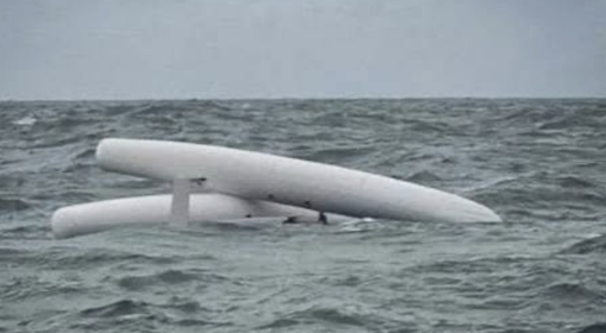

Hit something then. Structural failure on a modern dinghy catamaran is a ‘never happens’ event just by sea and wind. Rig failure due to mast inversion is possible, you have to ease both sails at once in survival conditions, but breaking up? That’s a first.
From the Solent Rescue page:
Difficult to interpret that picture, but can anybody determine from this what type of catamaran it is/was? I can’t identify it.
As Chiara says structural failure of a recognised class catamaran is virtually unheard of (though dropping a rig or other gear failure can happen).
Crossbeam failure or detachment due to lack of maintenance or previous damage is more likely than a collision with an unidentified floating object - that would possibly hole a hull or break a centreboard or rudder. Very odd looking hulls especially the rounded shape at what I’d guess as being the aft end, and what appears to be a centrally mounted rudder. Some sort of inflatable?
… striking similarities with Ducky 16 Inflatable Catamarans apart from the lack of a stripe.
The sentence in that description/specification "At peak loads, pipes can rotate in joint units," describing the frame, might match the photo of the two hulls at angles...
Edit: actually the word used is "floats", not "hulls". Maybe "hulls" would sound altogether too architectural!
That does look very much like that. Not sure I’d wish to be out by the Needles on one. It’s either windy and rough, or else not enough wind to make against the tide.
If it is one of those, note it is RCD CAT D - Inland or sheltered waters only! another candidate for the Darwin award maybe.
