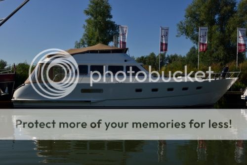

The 46 foot version you see above, is a semi displacement, single engine version for the dutch river network and coastal work.
we have attained a full rcd A rating, with Lloyds approval, for the design, and weld schedule.

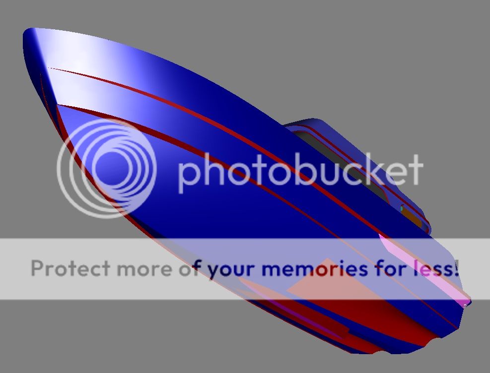

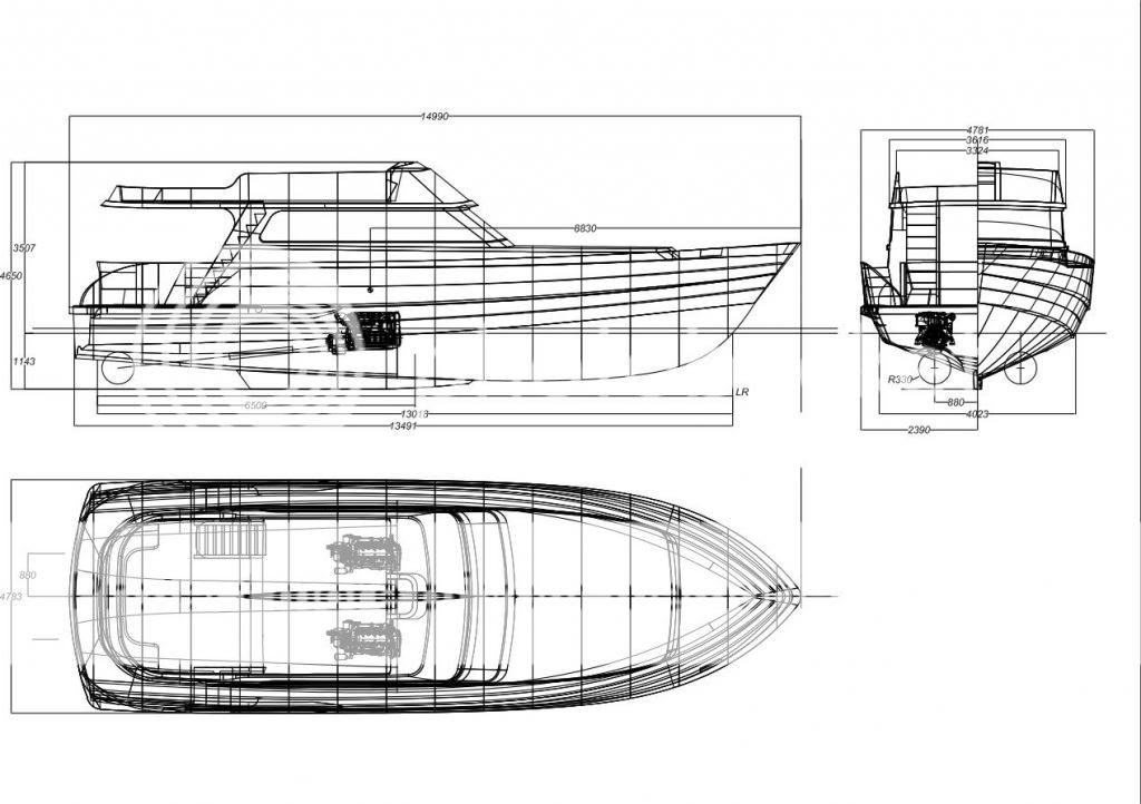

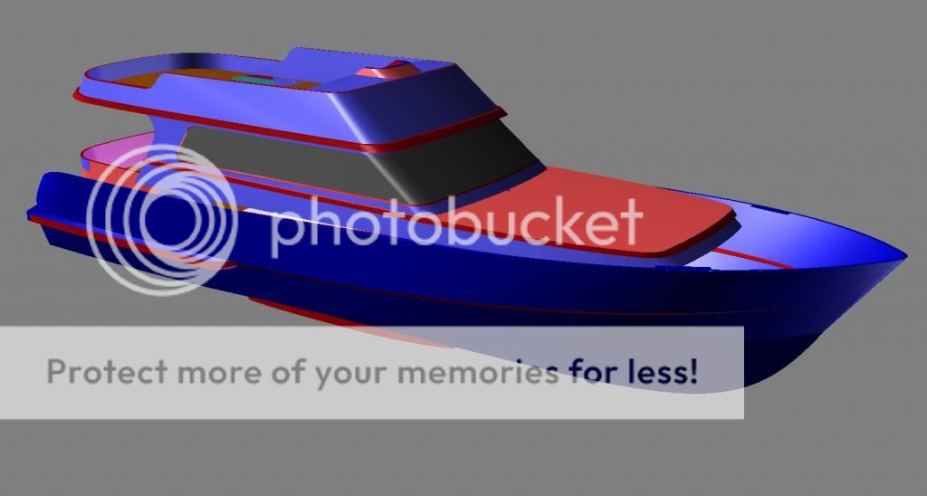

The CAD drawings below show the new bang up to date window system we are going for which hopefully will give a modern twist to classic shape.
Also showing the new planing hull, with inset tunnels. 20knots cruise was my goal, with a max 26 knots.
bare hull weight at 14,000 kg.

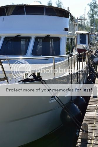

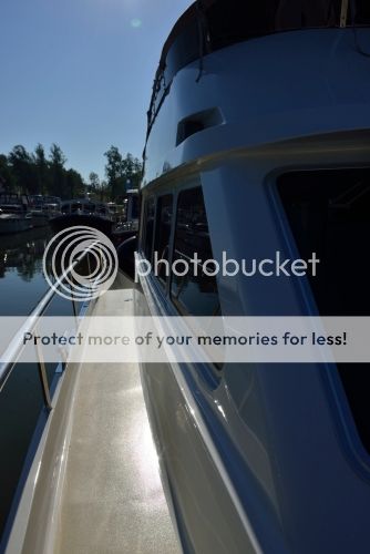

The 46 footer I looked at was finished to an exemplary standard of steel work, and shows full well what is capable of doing. to the point where you could with a magnet just to check its not plastic.
no roller marks, no sharp edges, or prominent weld profiles. just a stunning build.

Good luck with this Rob, and I'm looking forward to following this thread, and watching your new boat develop. I'm assuming your 14 tonnes is a bare hull with no mechanicals? I guess she will way 20 odd tonnes ready to go?

we have an allowed 2 tonnes for motors, shafts stern gear etc. gives us four tonnes to play with for fit out.
looking at three cabins if possible. I struggle to sometimes get to grips with drawings, will know what we have to play with at christmas when the steel work is complete.
engines are cummins 6.7l 480 ratings. the torque figures were really good for over the hump improvements on the 5.9l
aft galley layout, bi fold doors.
single sleipner bow thruster. after talking to lots of skippers, and watching boats park up, most don't use the stern for twin screw boats, so thats been dropped. still using hydraulics though, but driven through a clutch from the main engine, not a gearbox PTO.
Actually, watching lots of people cast off, and moor up.... lots dont use there engines as they should and rely on the bow thruster... or so it seems.
